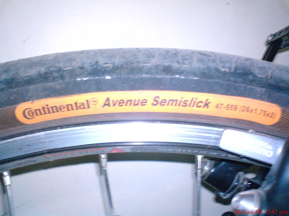

If U don't mind can you pls post pics of the tyre??? What brand are the tyres???

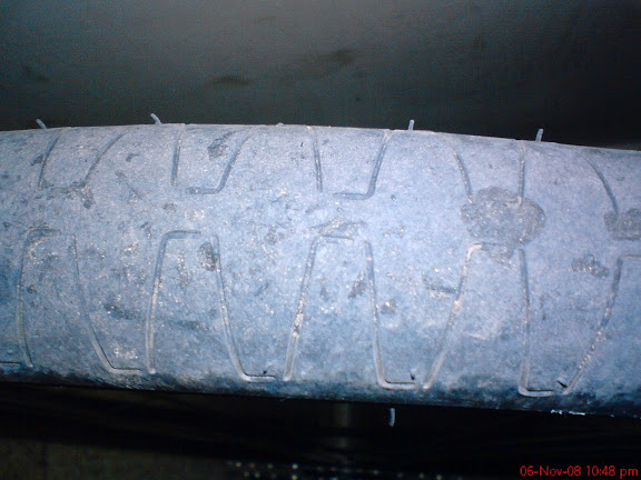

Postby iggy » November 7th, 2008, 12:23 pm
Cool KK i will do that when i am back home tonight and put up the picture the make is Continental Tires
I am so sorry about the delay but hear they are
and these are tire grip it does look worn out but its not really
Hope this helps

thnx yaar,
waiting for venky to source these for me
